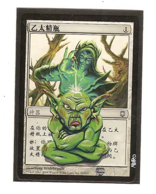

Mago dei Gingilli (Phyrexian Dreadnought)
Aether Vial jappo (Goblin Lackey)
Forbidden Orchard (Tidespout Tyrant)

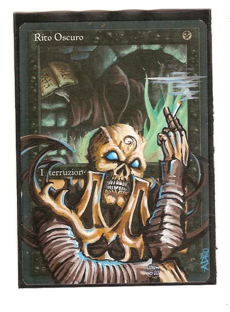

Rito Oscuro (Necropotence)

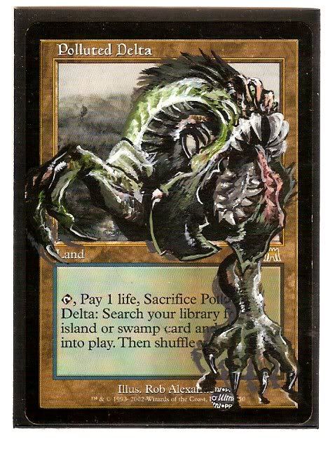

Polluted Delta (Tarmogoyf)

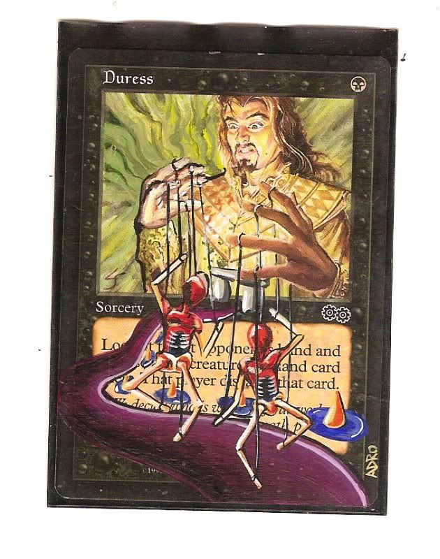

Duress (Time Walk)

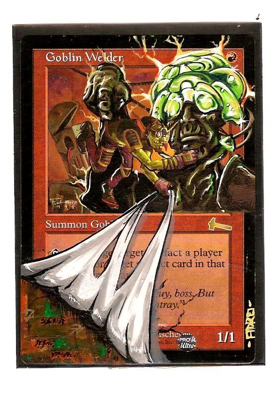

Goblin Welder (Mind Slaver 1)
Goblin Welder (Mind Slaver 2)

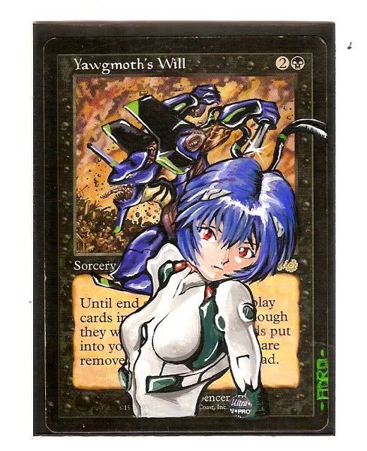

Yawgmoth's Will (Evangelion)
